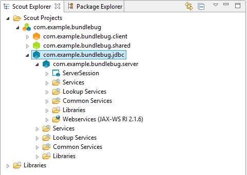

Then this looks like here:
index.php/fa/18631/0/

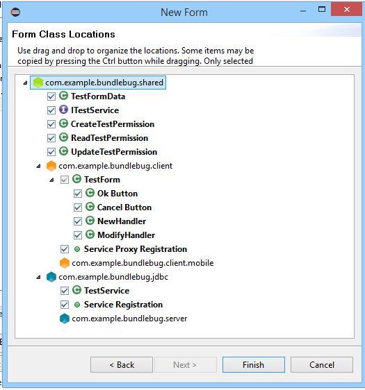

When I create a new form - lets say TestForm - the wizard shows:
index.php/fa/18632/0/

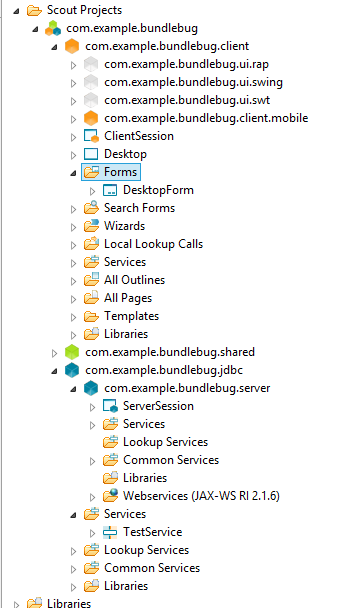

- TestService is at the wrong place (which was obviously already in the wizard wrong)
- TestService is not registered in the extension point
Note that I search for the TestForm, so it is missing classes and we can exclude a scout-explorer-bug...

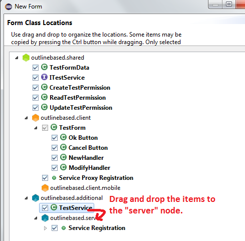

2/ With the current state, in the second step of the wizard, you can drag and drop the items:
index.php/fa/18635/0/
If you put the "TestService" and the "Service Registration" items to your server node (com.example.server) it will work.
