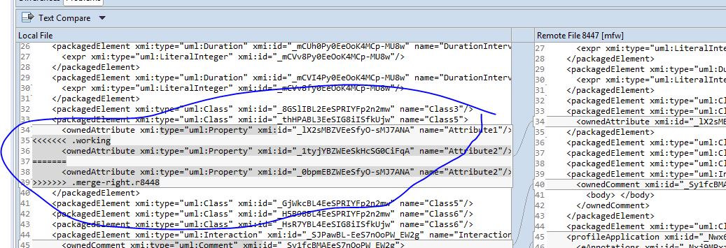

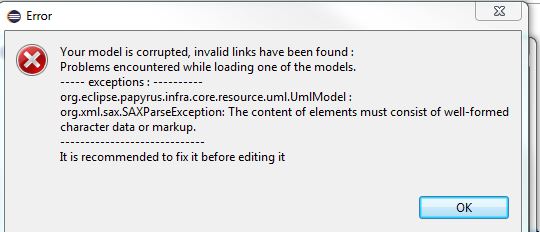

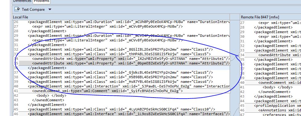

merging. Everytime you merge with the content of a branch, the compare
editor finishes with an exception related to the textual compare annotations
in the XMI. See pictures 1-3. After manually removing the content within the
workspace annotations (see picture 4) the compare model can be calculated
without any problems.
