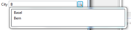

In SWT it looks like this:
index.php/fa/18607/0/
When I enter "Baden" that is not in the list, I can enter it:
index.php/fa/18608/0/
