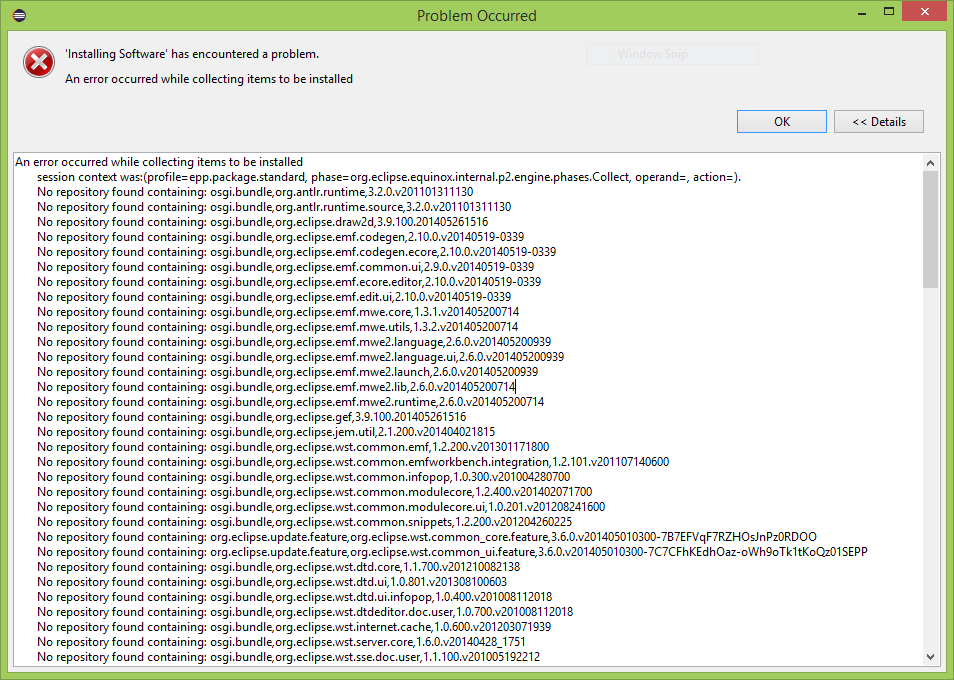

I recently installed Eclipse Luna, and I'm looking to start developing for JavaFX. I came across e(fx)clipse, and I'm interested in setting it up.
I came to realize that e(fx)clipse hasn't officially supported Luna except via the nightly builds. So I've attempted to install e(fx)clipse using this link below:
http://download.eclipse.org/efxclipse/updates-nightly/site
Unfortunately when I run this the installation (selecting the IDE bundle), I result in this error (see attached file).
Despite resulting in this error, I was able to successfully install e(fx)clipse for Eclipse Kepler, but I do not know if this will cause me any problems later on. I don't want to use a plugin that isn't designed for my software unless I will not encounter compatibility issues.
I appreciate your help. I would really like to see this working for Eclipse Luna Smile

In fact I'm having other issues with even reinstalling the Kepler version.
Original I installed the Kepler version which worked. Then I uninstalled it and installed the Luna version. Unfortunately that didn't work. Now I am unable to revert to the Kepler version.
I guess I'm a bit lost Sad

Have you tried the all-in-one version ?
http://downloads.efxclipse.bestsolution.at/downloads/nightly/sdk/

Did you check "Contact all update sites during install to find required
software"?
Tom

Simply use http://downloads.efxclipse.bestsolution.at/downloads/nightly/sdk/
Tom
