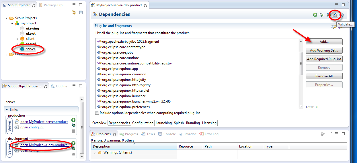

Re: Scout server not starting anymore [message #1402910 is a reply to message #1402909] Fri, 18 July 2014 06:12 Go to previous messageGo to next message
Hi Lukas,
Check the validity of your {{your_project}}.server/products/{{developpement/production}}/{{project}}-server.product
You can use validate to see if you are your product file contained all required bundles.
I assume you will get an errors because some plugins are missing missing.
You can add it with add.
index.php/fa/18572/0/
Hope this helps,
Matthias

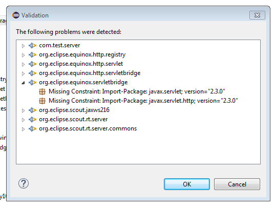

Re: Scout server not starting anymore [message #1693616 is a reply to message #1403175] Sun, 26 April 2015 16:11 Go to previous messageGo to next message
I'm having a similar problem I just noticed, but I can reproduce it from a freshly downloaded, unmodified scout 4.4 project.
To be specific: my server's production launch configuration reports missing dependencies javax.servlet and javax.servlet.http (when I click on "Validate..." from the server .product configuration).
index.php/fa/21664/0/
(edit: for the record, all of the bundles in the screenshot are missing the same two packages)
I take it this doesn't happen for the development .product config because there is a jetty implementation providing those packages. Question is: is it okay to have them missing for the production? Should I just ignore this weirdness, or could it be a symptom of something more sinister?
The thing is, when I export the project and deploy onto a local tomcat server, it works fine (server, rap and swing).
To recreate:
  1. download and unpack latest eclipse-scout-luna-SR2-win32
  2. create new workspace with new scout project called "com.test", using New Eclipse Luna target (4.4, current)
  3. open test-server.product (not the test-dev-server.product). click Validate... to see the dependency warning.
  • Attachment: error.png
    (Size: 19.74KB, Downloaded 1035 times)
[Updated on: Sun, 26 April 2015 16:12] by Moderator
Re: Scout server not starting anymore [message #1693619 is a reply to message #1693616] Sun, 26 April 2015 16:35 Go to previous message
As I have discussed it on the deploy on WildFly thread, those missing packages are OK.
It does'nt prevent the server application to be built and to be deployed.
My understanding is that if you deploy on tomcat, those packages will be provided by tomcat.
(it should be the same with other application server, but I have limited knowleged in this area).
