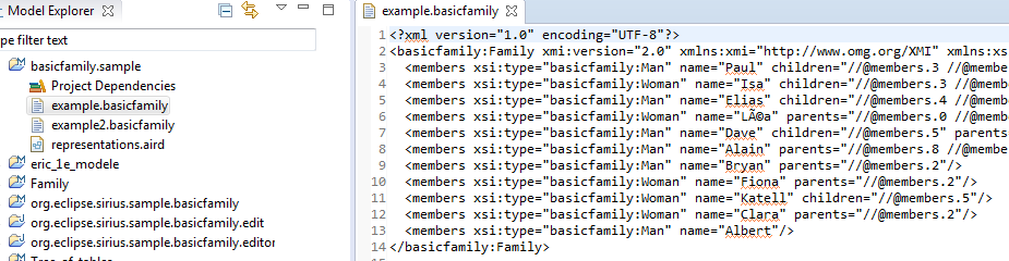

I'm going thru the Sirius tutorial with Sirius 1.0.0 in Eclipse luna
https://wiki.eclipse.org/Sirius/Tutorials/4MinTutorial#Import_a_sample_model
When I import example.basicfamily from the file system, it doesn't get displayed as in the tutorial. The family members aren't imported.

  • Attachment: Capture.PNG

By installing only the Ecore Diagram Editor feature, you can only use Sirius in the specific context of Ecore. That is why you see the family model in plain text instead of a model.
If you want to go through the Sirius tutorial you will need to install the whole framework. Check the Sirius features (like Ecore Diagram Editor it is in the category Modeling) or you can user the Eclipse Marketplace (see https://www.eclipse.org/sirius/download.html).

Re: Import sample model => family members aren't imported [message #1402887 is a reply to message #1402831] Fri, 18 July 2014 04:28 Go to previous messageGo to next message
In that case, I think that something is missing around the step
https://wiki.eclipse.org/Sirius/Tutorials/4MinTutorial#Import_the_projects_defining_the_sample_Domain_Model
.. Are you sure that you imported the 3 projects in your workspace, then
launched a new Eclipse runtime before creating a modeling project with
the basicfamily sample?

Re: Import sample model => family members aren't imported [message #1403209 is a reply to message #1402887] Tue, 22 July 2014 07:18 Go to previous messageGo to next message
Hi Steve
you're right: that was the missing element!
Now I'm able to go thru the tutorial. Smile
Thanks!
Eric
Re: Import sample model => family members aren't imported [message #1403862 is a reply to message #1402887] Mon, 28 July 2014 06:23 Go to previous message
Much tks for your reply, I met the same problem. Right, it must run a new eclipse runtime to solve.
