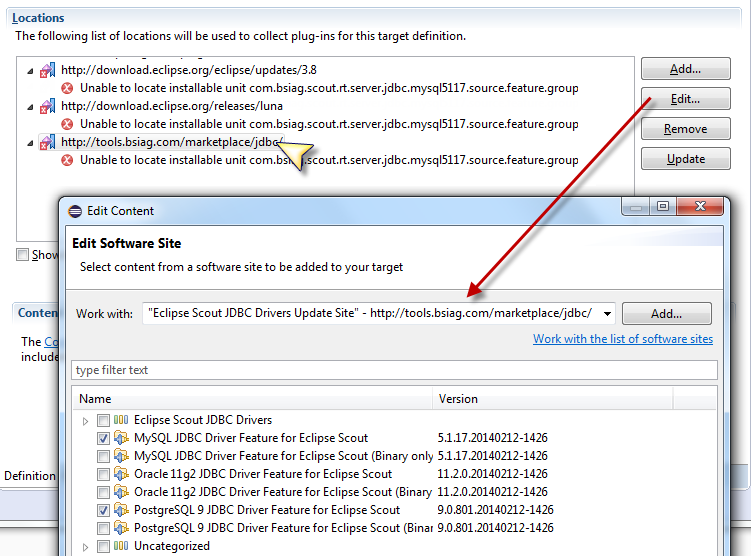

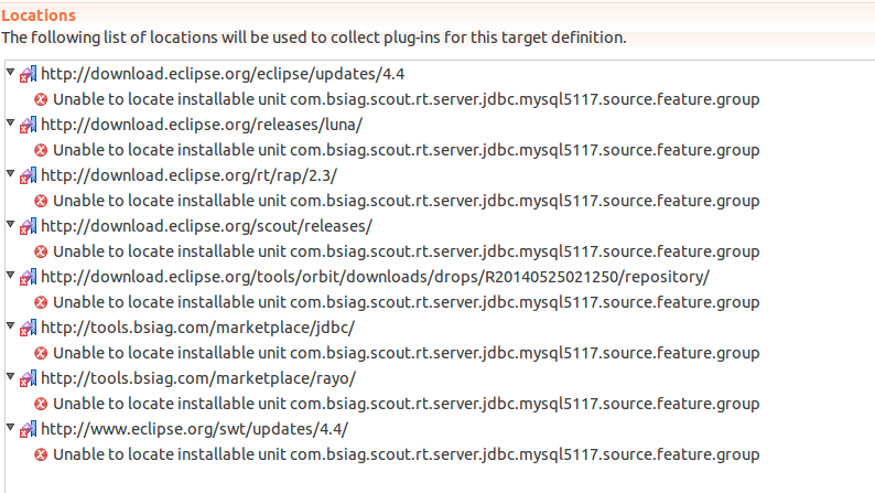

It's been two days that I simply can't get how the target platform should work..

And this is what the target editor looks like
index.php/fa/18559/0/

Re: Target and Tycho [message #1402209 is a reply to message #1402143] Wed, 16 July 2014 13:36 Go to previous messageGo to next message
For your first Problem in the target Editor, I could reproduce it (by adding your "JDBC <location>" content in my target platform).
I used the Editor to fix it:
index.php/fa/18565/0/
Now it Looks like this:
<location includeAllPlatforms="false" includeConfigurePhase="true" includeMode="slicer" includeSource="true" type="InstallableUnit">
<unit id="com.bsiag.scout.rt.server.jdbc.mysql5117.source.feature.group" version="5.1.17.20140212-1426"/>
<unit id="com.bsiag.scout.rt.server.jdbc.postgresql9.source.feature.group" version="9.0.801.20140212-1426"/>
<repository location="http://tools.bsiag.com/marketplace/jdbc/"/>
</location>
Do not ask me why (the target Editor is buggy)... I hope it helps.
Re: Target and Tycho [message #1402581 is a reply to message #1402209] Thu, 17 July 2014 03:22 Go to previous messageGo to next message
The problem is that if there is an installation that can't be located I comment it and then a new one can't be located...
Re: Target and Tycho [message #1402725 is a reply to message #1402581] Thu, 17 July 2014 07:57 Go to previous messageGo to next message
Apparently it has something to do with adding the sources of each unit . Here's a new target file and at least it doesn't give me anymore errors in the console and the builds are successful. However, this builds don't seem to work either and the target view in eclipse still shows errors and I have no idea why...

Re: Target and Tycho [message #1402732 is a reply to message #1402725] Thu, 17 July 2014 08:10 Go to previous message
well well hehe
.. seems to work fine! the target view in eclips eno longer has errors I had to update the maven projects with alt+F5 and also to upgrade the target platform in window / preferences / target / upgrade
However I have not fixed entirely the dependencies
As son as I have the test results I'll post my findings.
