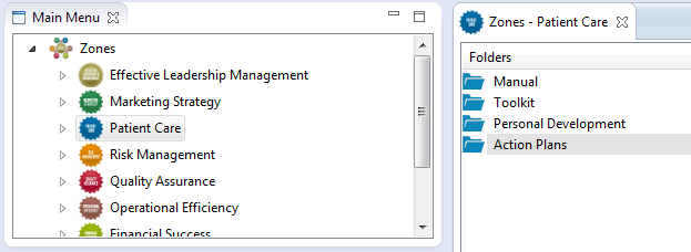

I have an application which has a table node page to the left and an associated table page to the right.
The problem is that when a user hits the right hand close window button, the window closes and can never be re-opened without restarting the application.
This applies to all nodes on the left hand side, double clicking any of these nodes no longer opens the table page on the right.
I have attached an image of the app for clrification.

From the screenshot I can see that you have SWT.
