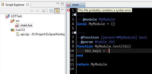

Re: Some scripts got 'This file probably contains a syntax error' after upgrading from 1.1 to 1.2 [message #1403084 is a reply to message #1402951] Mon, 21 July 2014 05:22 Go to previous messageGo to next message
Hi Marc,
Finally I found a minimal reproducible test case. Attached is the LDT project.
Eclipse Indigo SR2 20120216-1857
LDT 1.2.0.201406251556
Thank you.
index.php/fa/18602/0/
Re: Some scripts got 'This file probably contains a syntax error' after upgrading from 1.1 to 1.2 [message #1403113 is a reply to message #1403084] Mon, 21 July 2014 08:39 Go to previous message
Thx Cheyi Lin, you definitely find a bug.
I report it : https://bugs.eclipse.org/bugs/show_bug.cgi?id=439995
We will try to fix it in the version 1.2.1 .
Waiting the workaround is to not typed the field tbl as a table.
