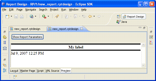

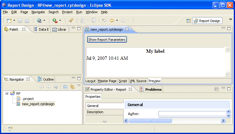

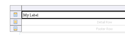

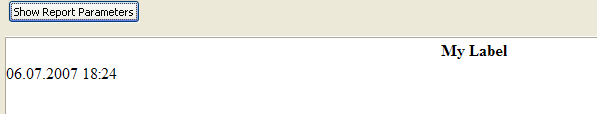

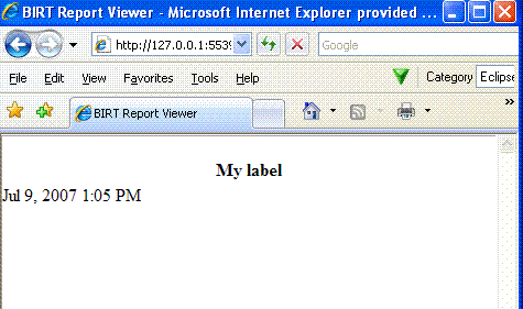

I have found differences in HTML and PDF output results.
For example I have created new report and put into a Grid(1,1). Into the
grid I put Table(1,1,none) and into a header cell of the table I put Label
and entered some text ("My Lable" for example). For the header row I set
black border. (see im1)
When I switched into preview I found the label text in center of report and
with bold attribute (and probably another size). There is not any border at
all. (see im2)
In PDF output it looks ok. (see im2)
Could somebody help me?
Best
Kirill.

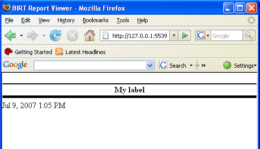

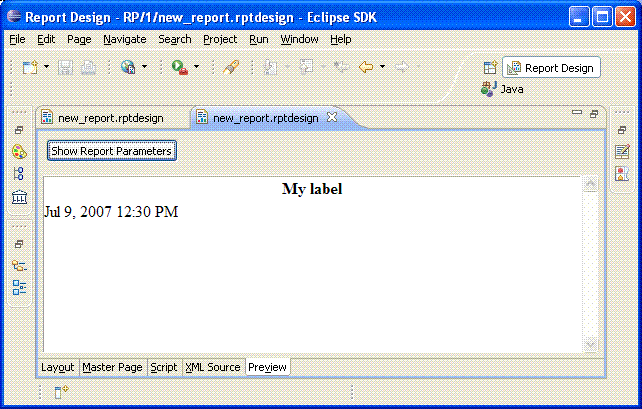

Re: Some problem with 2.2 release [message #246863 is a reply to message #246844] Mon, 09 July 2007 04:41 Go to previous messageGo to next message
Yes, I forgot to set border.
But. In my preview the label text of your report is _centred_ and _bolded_
(see pic1)
Also if I remove border from the table cell and set it on the table _row_
it is not drawn (see new_report.rptdesign and pic2)
Best Kirill

Re: Some problem with 2.2 release [message #246870 is a reply to message #246844] Mon, 09 July 2007 05:08 Go to previous messageGo to next message
Once more:
1 - It has a different look in external browsers (IE7 and FireFox, see
pic_IE7 and pic_FF)
2 - If I change http://127.0.0.1:55398/viewer/run?... to
http://127.0.0.1:55398/viewer/preview?... label jump to left :(
Kirill

Re: Some problem with 2.2 release [message #248042 is a reply to message #246870] Mon, 16 July 2007 06:10 Go to previous message
In BIRT2.2, html performance is enhanced.
As a cost, several codes to adjust the difference between BIRT and browser
are removed.
In this case, BIRT output header using <th> tag and some browsers will make
it centered and bold.
You can try to write below html and view it in different browsers.
<html>
<head>
</head>
<body>
<table style="width:100%">
<tr><th>table header</th></tr>
</table>
</body>
</html>
If you need to make it align left, you can try to add a explicit style to
set its text-align to left.
BTW, see bug https://bugs.eclipse.org/bugs/show_bug.cgi?id=194082 which
maybe describe the same issue.
