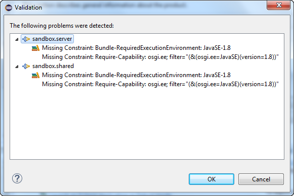

When I try to validate the product files (for example the server-dev.product), I get validation errors.
<the app>.server/products/development/<app alias>-server-dev.product
index.php/fa/18509/0/

I checked everything:
* Preferences > Java > Installed JREs
* Preferences > Java > Installed JREs > Excution Environments
* Preferences > Java > Compiler: JDK Compliance Compiler compliance level
Everything seems to be OK (Java 8 or 1.8 everywhere)
The workaround is to replace:
Bundle-RequiredExecutionEnvironment: JavaSE-1.8
With:
Bundle-RequiredExecutionEnvironment: JavaSE-1.7
in all MANIFEST.MF files.
Is someone experiencing the same problem?
What is the solution to this problem? (I am aware that the problem might be somewhere else in Eclipse IDE - Maybe PDE?)

To reproduce the problem, a very important point is to select "New Eclipse Juno Target (3.8 recommended)" as Eclipse Platform.
I think the problem is somewhere there.

This is because the 1.8 execution environment is only available on equinox luna. As Eclipse 3.8 was a Juno release, this support is not available there.
In other words: the java 1.8 support only works with an eclipse luna target.
I created Bug 439333 to fix this in the scout SDK.
