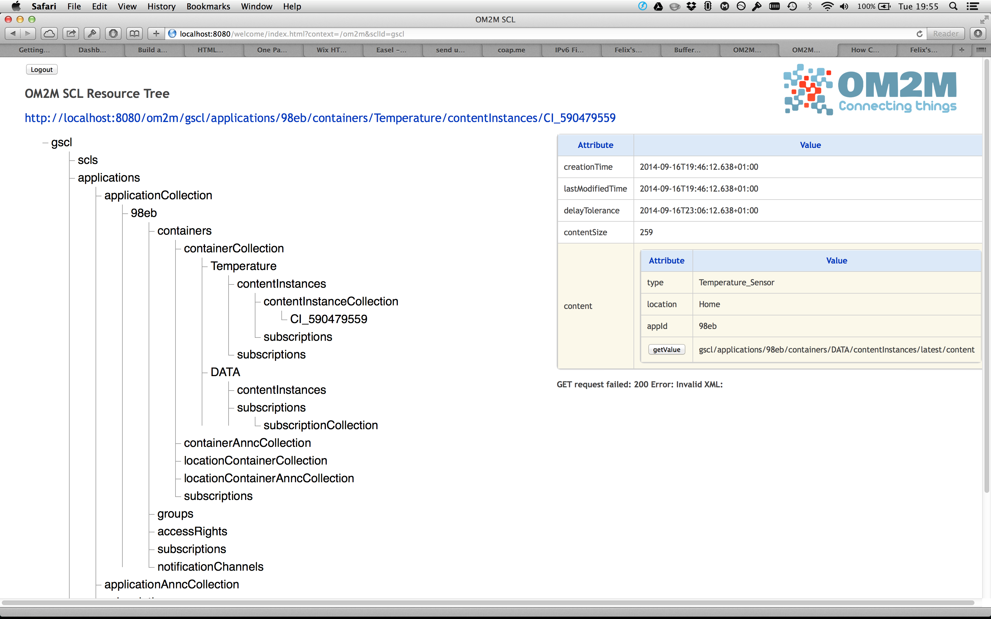

I'm hijacking this thread as I was about to create a new topic to ask pretty much the same thing. I will do it here since I still don't understand a few things.
I've successfully deployed a nodejs app which creates a new application whenever an Arduino node sends a specific CoAP PUT (had to use Ponte, because there is still no official CoAP-HTPP binding). However, I now need to create a web page to interact with my GSCL (it should actually be a NA interacting with NSCL, but I'm just testing it right now)...and that is where the problem resides. I've tried to GET the /latest/content using the built-in Web App, but I did not succeed as you can see in the print screen. I wanted to try it using Postman (or any other client), but I don't know how to, since I can not enter admin/admin (encoded to base64) in that GUI... Could anyone help me here? :\ I need to test if I can get the response in plain text. This will also be the path to where Arduino sends the temperature value.
Thanks in advance!
Off-topic but important: If I wanted to this the right ETSI standard way, what would be the correct procedure when deploying the web page (NA). I'm guessing the NA should contact NSCL which in turn possesses the value sent by the Arduino via GSCL - am I right?
Pedro.
  • Attachment: om2m.png
    (Size: 639.75KB, Downloaded 304 times)

Hello Pedro,
1) In Postman you should add the following Authorization header with a base64-encoded "admin/admin" like this:
- Name: Authorization
- Value: Basic YWRtaW4vYWRtaW4=
You can import if you want this sample Postman request collection from this link: https://www.getpostman.com/collections/d752700c8a4584e81296
can you show me the representation of the contentInstance created in the DATA container ?
Actually, the OM2M build-in web itnerface is able to parse this kind of oBIX representation:
<obj>
<int name="data" val="27"/>
<int name="unit" val="celsus"/>
</obj>
Otherwise you can send a row data and consume it using your specific client.
2) For your NA, of course it is better to request the NSCL to get resources from the GSCL to be compliant with the ETSI M2M standard.
It is really easy and seamless, all what you have to do is to send the same request to the NSCL ip address (instead of the gscl ip address) like this:
GET nscl_ip:nscl_port/om2m/gscl/applications/98eb/...
The NSCL will automatically retarget the request to the appropriate GSCL.
Your NA will always use the NSCL ip address. It will not even be aware that the request is sent to another machine.
It is like browsing a simple web site, but technically we are browsing a variety of machine in a seamless way.
[Updated on: Wed, 17 September 2014 09:58] by Moderator

Great! Thanks a lot for the reply.
1) I did manage to get POSTman to work afterwards. The problem I had had to do with the default login being "admin/admin" instead of "admin:admin". If you use POSTman web interface for username and password field, the result is the encoded "admin:admin" instead of "admin/admin". Anyway, it works now.
The representation is now working. It was a coding syntax error...I forgot to add " " in my javascript code, and that was why the web interface could not then parse the representation.
2) About the NA - that is super. Didn't know the standard would work like that but it makes total sense!
