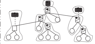

Hi Maxime,
Are there available tutorials on creating designs using container diagram elements?
I would like to create a diagram (in the attached image) using container diagram. The nodes of this tree are imported from a separate Ecore file and I don't know how to go about the creation of this image using Sirius. Could you please help me out?
Thank you.
  • Attachment: WhatIWant.png
    (Size: 22.40KB, Downloaded 267 times)
