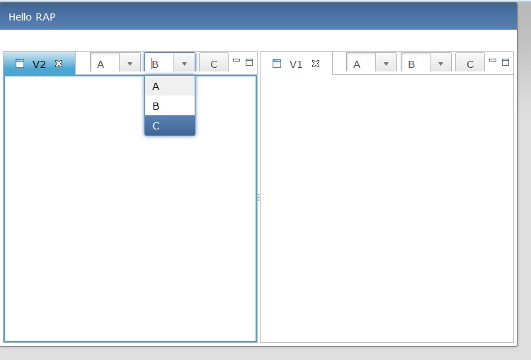

However, I managed to create a sample application in which it actually works. This is quite strange...
See attached imaged.
Matteo
EDIT:
I just read your answer on the bug tracker. I just managed to "avoid" the issue by preventing to set focus on the viewer in my view. (In fact in a view without a viewer it works correctly..)

Re: Combo box in Window ActionBar [message #1401229 is a reply to message #1401161] Tue, 15 July 2014 06:07 Go to previous messageGo to next message
this will work if ViewPart#setFocus does not set the focus (empty
implementation).
