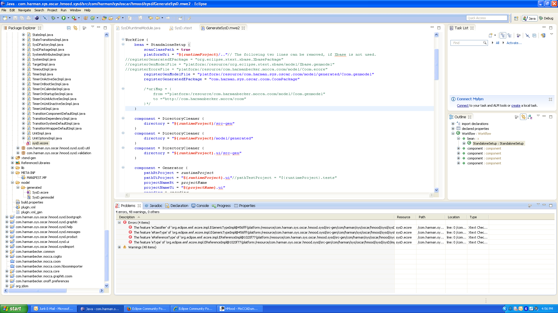

Hi All,
I am trying to create the DSL editor.
I have an ecore named coom. Also I have developed graphiti diagram for the same.
Also I have DSL named sysd.
Note : sysd and coom are completely different
Now I want to import coom in my sysd file. So in my sysd.xtext file I added the below line
import "platform:/resource/com.harman.sys.oscar.coom/model/generated/Coom.ecore" as coom
In the workflow i added
registerGenModelFile = "platform:/resource/com.harman.sys.oscar.coom/model/generated/Coom.genmodel"
registerGeneratedEPackage = "com.harman.sys.oscar.coom.CoomPackage"
Then i generated the artifacts with no erros.
When i try to import coom file in sysd. I get xtext validation popup telling
An internal error occurred during: "Xtext validation".
java.lang.IllegalStateException: No IResourceServiceProvider found in registry for uri compB.coom
Also i am able to see some errors in the sysd.ecore which is in src-gen sysd.impl folder. I dont understand why 2 sysd.ecore
org.eclipse.emf.common.util.WrappedException: java.lang.IllegalStateException: No IResourceServiceProvider found in registry for uri compB.coom

Re: Using Existing Ecore in XText [message #1400577 is a reply to message #1397139] Mon, 14 July 2014 08:10 Go to previous messageGo to next message
Hi Christian,
The example which you have mentioned works fine. but the issue is if the Grammer in DSl2 increases, it simply complains. I guess the problem is with generator.
please refer the example which i have ....
https://www.dropbox.com/s/bb5s58t5cummu05/WS2.zip
sysd and coom are my dsl's
1. In Sysd file remove all the Grammer related to Component, State and System (Also remove coom import),Generate, it works perfect
2. Now Keep only Component, State and System and remove everything, generate it works
3. But the Grammer that i have shared does not have any error, no java compile errors but generated two sysd.ecore file . one in model/generated/sysd.ecore and src-gen/com....impl/sysd.ecore(This file is having some reference issues)
Can you please look in to it.. I guess this is xtext bug.
Girish
Re: Using Existing Ecore in XText [message #1400742 is a reply to message #1400577] Mon, 14 July 2014 12:54 Go to previous message
this is definitively a bug in xtext. please file a bugzilla
