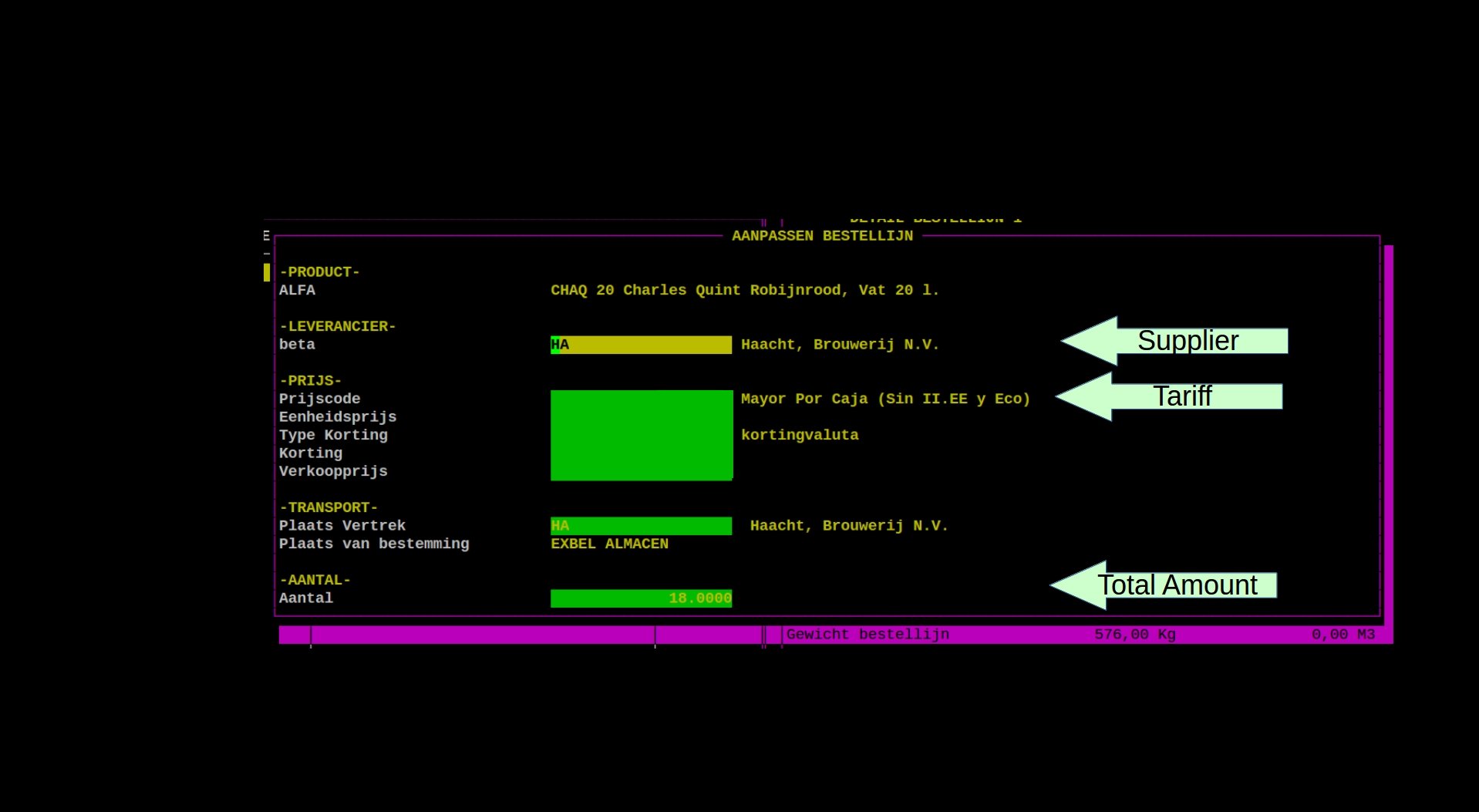

I need to start porting a TUI application towards a modern application environment.
Eclipse Scout could be a possible solution.
In the old days as one when sequential throught all field one could impose pre and post conditions on each field.
In case of clipper it was with "WHEN" and "VALID" on each field during the get statement.
Is there a possibility to do the same thing in eclipse scout ?
See e.g. below screenshot.
index.php/fa/18492/0/
- When one leaves the field supplier, the fields with the tarrifs are filled in.
- When leaving the field Total Amount, inventory is checked, and the user is given the possibility to either correct the amount based on available inventory or adjust the total amount.
My Question : Is there a possibility to have this kind of field validations in eclipse scout so when one tries to leave a field, a call is sent to the server to validate certain information, or to update other fields with new information.

Re: Converting a TUI user interface (former Clipper application) towards scout [message #1396341 is a reply to message #1396069] Tue, 08 July 2014 03:08 Go to previous messageGo to next message
Hi Tore,
glad you are evaluating Eclipse Scout for your project.
Eclipse Scout does have a sophisticated validation framework. I can't see your screenshot (I guess this is a eclipse forum problem) but your usecase should be possible.
