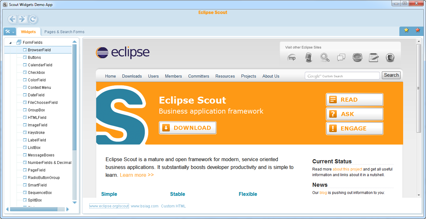

I did try the browser field with our demo widget app and it works fine in swing:
index.php/fa/18499/0/
Can you provide some more information?
1) Can you paste the java code of the browser part in your project?
2) Which version of Scout are you using?
Matthias

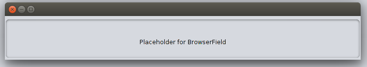

Re: Swing Browser [message #1396377 is a reply to message #1396348] Tue, 08 July 2014 04:06 Go to previous messageGo to next message
I'm using Luna 32 bits I downloaded it a week before the official release.
The code I'm using is the same that I saw in a forum topic. The weird thing is that it works fine with swt and RAP. In swing it says "placeholder for

This is the picture
index.php/fa/18501/0/
There are no error messages in the console only the "Placeholder for Browser Field"
Re: Swing Browser [message #1396383 is a reply to message #1396377] Tue, 08 July 2014 04:19 Go to previous messageGo to next message
Hi Betty,
I just tried with the latest Luna release and I experience the same problem.
Solution:
1) open your swing development product file: In my case it is <my-project>.ui.swing/products/development/swing-client-dev.product
2) Go to Dependencies tab
3) Click on "Add..." button
4) Choose "org.eclipse.scout.rt.ui.swing.browser.swt.fragment"
5) Go to Overview tab
6) Press synchronize
7) Press Launch application
Does this solve your problem?
I will open a bug for this later on.
[Updated on: Tue, 08 July 2014 04:20] by Moderator
