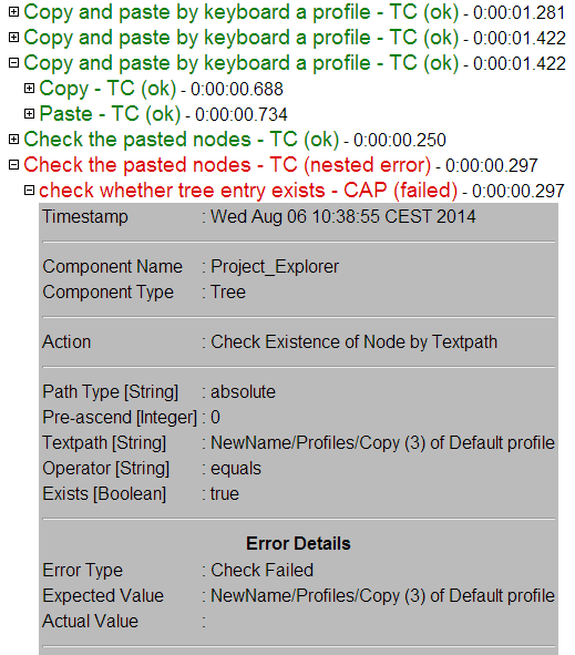

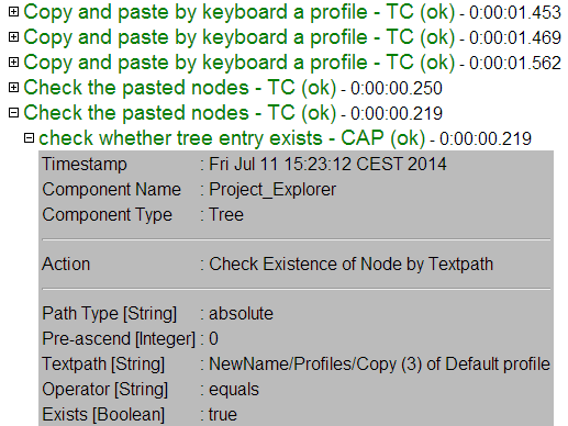

Re: Errors which appears with the automated tests [message #1404997 is a reply to message #1395613] Wed, 06 August 2014 06:40 Go to previous messageGo to next message
Thanks for your reply and sorry for my late answer.
Actually, I think some error are the results of a slow-down of my virtual machine. But for the error on drag'n'drop actions I can't explain the error.
I understand the reason of the fail step because the check can't be realized because the element doesn't exist. But I can't explain why it works one day and not another with no change in the test suite and in the AUT. This kind of problem is really time-consuming so I really like to resolve this issue.
I join a copy of the step passed yesterday and the step result today. Between the two run no modification has been made on the AUT and on the Test Suite.
Thanks for any advice.

Re: Errors which appears with the automated tests [message #1405027 is a reply to message #1393743] Wed, 06 August 2014 08:04 Go to previous messageGo to next message
Hey,
could this be a timing issue? Have you already tried to synchronize the executed steps e.g. adding some wait actions?
Re: Errors which appears with the automated tests [message #1408247 is a reply to message #1405027] Thu, 14 August 2014 11:37 Go to previous message
I don't think it's a timing issue because I've tried to add some wait actions and the error happened. I've to double my select node action to solve the problem...But I think it's not a good solution (because before it works well).
