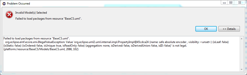

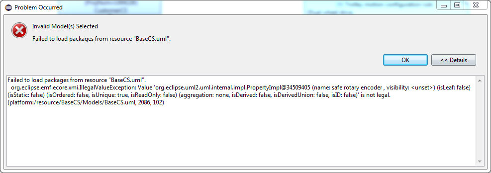

When I try to import an otherwise apparently healthy package (my biiiig mother-model...) to a smaller new project for reuse of some objects, I get the error shown in the attached dialog in Luna (Papyrus build 1.0.0v201406111317), but not in the latest Eclipse build.
I have had three of these so far, the first I could fix by deleting the the association that the problem seems to come from.
The log file does not register any problems, which is weird (the log file is also unnamed, perhaps another issue?)
IS this something known or should I log a bug in Bugzilla?

This error message indicates an ill-formed XMI serialization in your
model, which evidently has a reference to a Property where a reference
to an object of some other (incompatible) metaclass is expected.
If you put a breakpoint in the IllegalValueException constructor,
you'll be able to see which EReference of which EObject in your model
has this problem, then you can fix it in the *.uml resource with a text
editor.
