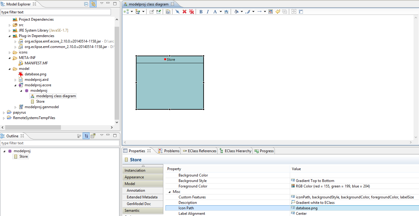

hello,
how should i write the icon path?.
I can only see a red square
I tried this:
/database.png
//database.png
/model/database.png
index.php/fa/18374/0/
  • Attachment: iconPath.png
    (Size: 66.13KB, Downloaded 751 times)
Re: Ecore Tools 2 Icon path problem [message #1389043 is a reply to message #1388596] Fri, 27 June 2014 04:53 Go to previous messageGo to next message
the icon path is in the form /projectid/some/folder/icon.png
In your case it should be /yourproject/model/database.png, it will also work if your icon is bundled in one of the installed plugins.
Re: Ecore Tools 2 Icon path problem [message #1389283 is a reply to message #1389043] Fri, 27 June 2014 11:25 Go to previous message
Thank you very much, it works.
