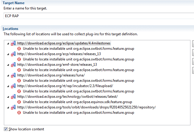

I tried to use RAP with Luna and ECP 1.3.
According to this thread:
https://www.eclipse.org/forums/index.php/m/1220805/#msg_1220805
the target file "ecpRAP.target" within the bundle org.eclipse.emf.ecp.target.rap should be used. However I get the following problems when trying to use it:
index.php/fa/18357/0/
I tried to use the latest target file from the master branch instead of the 1.3 branch - no success either.
Help is very much appreciated.
Thx,
Chris
Re: ECP 1.3.x RAP target does not resolve [message #1389020 is a reply to message #1387168] Fri, 27 June 2014 04:07 Go to previous messageGo to next message
Hi Chris,
I updated the target files on the master branch. Because of the Luna release, Milestones and RC versions were deleted.
Thank you for the report.

Re: ECP 1.3.x RAP target does not resolve [message #1391887 is a reply to message #1391123] Tue, 01 July 2014 11:01 Go to previous messageGo to next message
Hi Christian,
The only bundle you are missing is org.eclipse.emf.ecp.view.swt.layout . It is not needed if all controls are directly added to the view. This is also what the error says: Quote:
!MESSAGE Unable to create editor ID org.eclipse.emf.ecp.editor: There must be exactly one LayoutProvider!
Found 0 providers.
!STACK 0
java.lang.IllegalStateException: There must be exactly one LayoutProvider!
When you added Quote:
the controls-bundle + required plugins
you probably also added swt bundles and e4 bundles. Those are part of the rap.target but must not be added to the launch configuration.
The second StackTrace is produced because of the wrong dependencies.
I will fix the launch configurations to include the missing bundle so this use case works out of the box in the future.
Cheers,
Eugen
