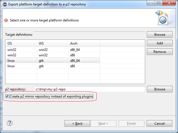

I wrote an export wizard, that can export p2 repositories (Must be selected using checkbox below):
Source: https://github.com/borisbrodski/org.eclipse.pde.targetplatformexporter
Update site: https://github.com/borisbrodski/org.eclipse.pde.targetplatformexporter/raw/updatesite/org.eclipse.pde.targetplatformexporter.site
index.php/fa/18694/0/
It's implemented really "quick and dirty", but it works Smile
Pull requests and comments are welcome!
