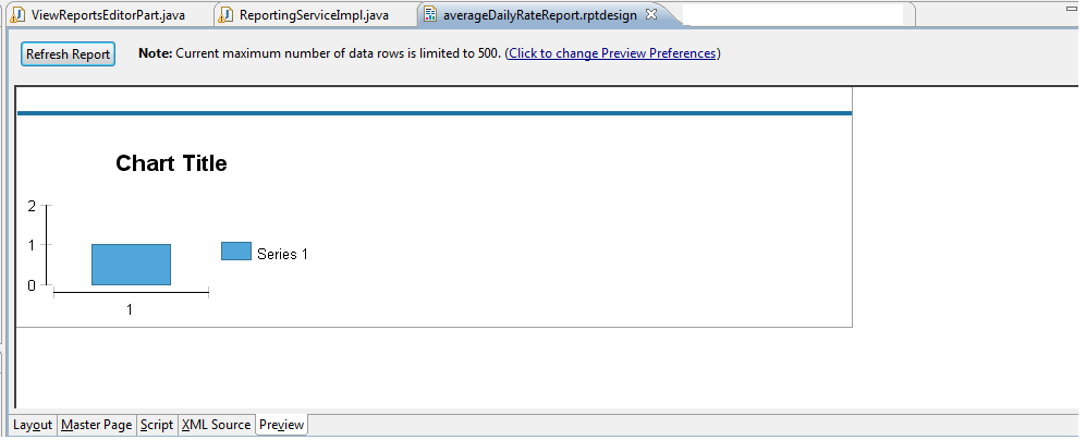

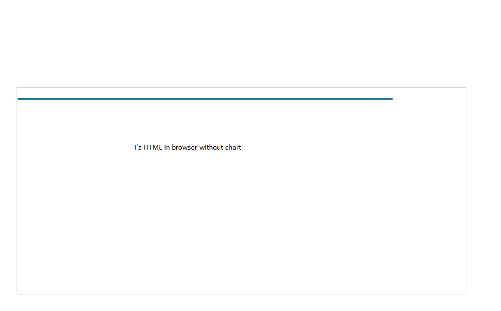

in my RAP application used BIRT reports. My report is not work when added chart. In BIRT persepcive preview report show good(image 1.png). When report formed from RAP I give NPE. Without chart report show good from RAP application (image 2.png).
What am I doing wrong?
