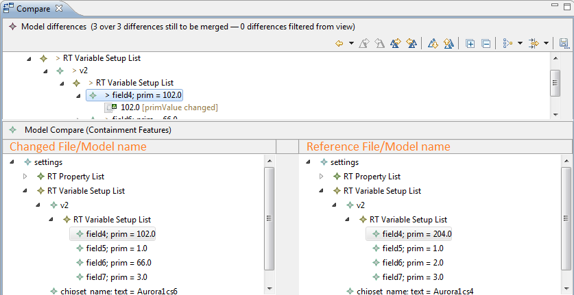

We are looking into the possibilities of customizing the CompareUI editor.
CompareUI.openCompareEditor(input);
Q1:
Is it possible to inject the names of the files/models that we compare, so that they can be displayed in the two bottom windows?
Else it can be quite confusing to keep focus on which model is the changed one.
index.php/fa/18302/0/
Q2:
Can we make a filter that also affects the two bottom windows?
It would be nice to be able to see the differences side by side without having to view the full model.

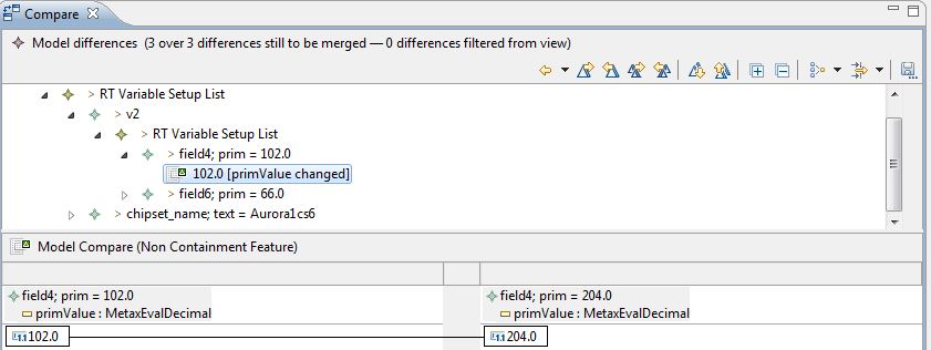

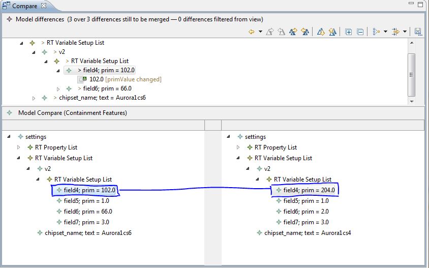

Q4:
Can we make the currently selected difference clearer by changing the color of the selection or by getting a thick line displayed between the changes.
The thick line is nicely displayed when comparing individual values, but not when displaying differences in the model.
index.php/fa/18303/0/
index.php/fa/18304/0/

Q1 : This has been recently fixed and the names are now displayed where you have orange text on your screenshot. IIRC, you can still alter them through the compareConfiguration (setLeftLabel, setRightLabel).
Q2 : No. We use the in-memory models loaded by EMF Compare and display them in a tree viewer, using the generated "edit" item and label providers for them.

Q4 : You'll find some of our colors in General > Appearance > Colors and Fonts (EMF Compare category), but I don't think the colors you seek are available in there. You might want to look at CompareColorImpl, where all five colors IDs are defined (though these are intenal and subject to change), and manually change them to something of your liking. If that works, please raise an enhancement request on the bugzilla so that we can look at how to open an API or add these colors to the preferences. Something like this might do the trick :
IThemeManager themeManager = PlatformUI.getWorkbench().getThemeManager();
final ITheme currentTheme;
if (themeManager != null) {
	currentTheme = themeManager.getCurrentTheme();
	currentTheme.getColorRegistry().put(CompareColorImpl.INCOMING_CHANGE_COLOR_THEME_KEY, <RGB of your choice>);
