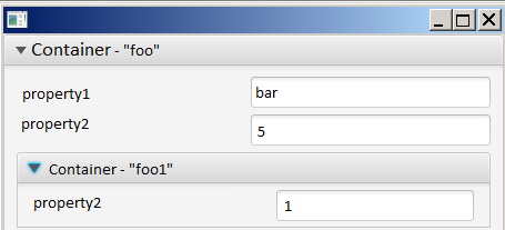

the model I have has 1:n relationship. This 1:n can be nested within each level.
This is concept how generated form for domain object from my previous post should look like:
index.php/fa/18293/0/
Each Container is represented as titled (using value from one of domain object features), expandable pane.
Other Elements can be shown in the following way: label comes from some domain model attribute, value from another one (values can be visualized using different UI elements, depending on the attribute type). however, the same class of objects should be visualized coherently.
I think tree with details is not enough as it should be possible to show whole content at once. Depth of containers is also not limited. Do you have any remarks, advices?
Tomek

I see!
What I would do is creating a custom renderer for the existing element
tree-master-detail. If there are any detailed forms within the sections,
I would define own view models for them and embedd them into the custom
renderer. We have implemented this in a client project before, but as
this is a very specific case, it did not become open source.
Please let me know, if you need support for this...
Best Regards
