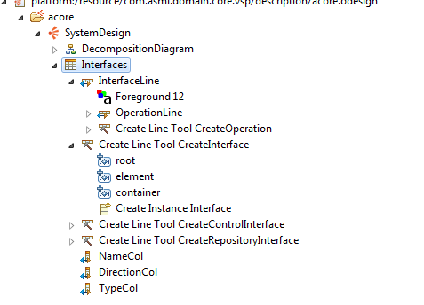

The root element in my metamodel is Model and it contains Interface entities. I want to represent the Interface entities in a table (and add new ones). I added an InterfaceLine and CreateLine tools to the description.
However, I am unable to create the first interface. If my model already contains an interface (created by some other means), then that interface shows up and I can add additional ones by right clicking that interface and select the proper tool.
How or where should I create the tool that allows me to create an Interface in an otherwise empty model?
I attached a screenshot showing the organisation of VSP description.

Normally, you should have a create tool that appears in the toolbar.
I attached a simple example project.

Hi Laurent,
Indeed, the solution was too simple. I'm feeling ashamed now. *blush*
Thanks again!
