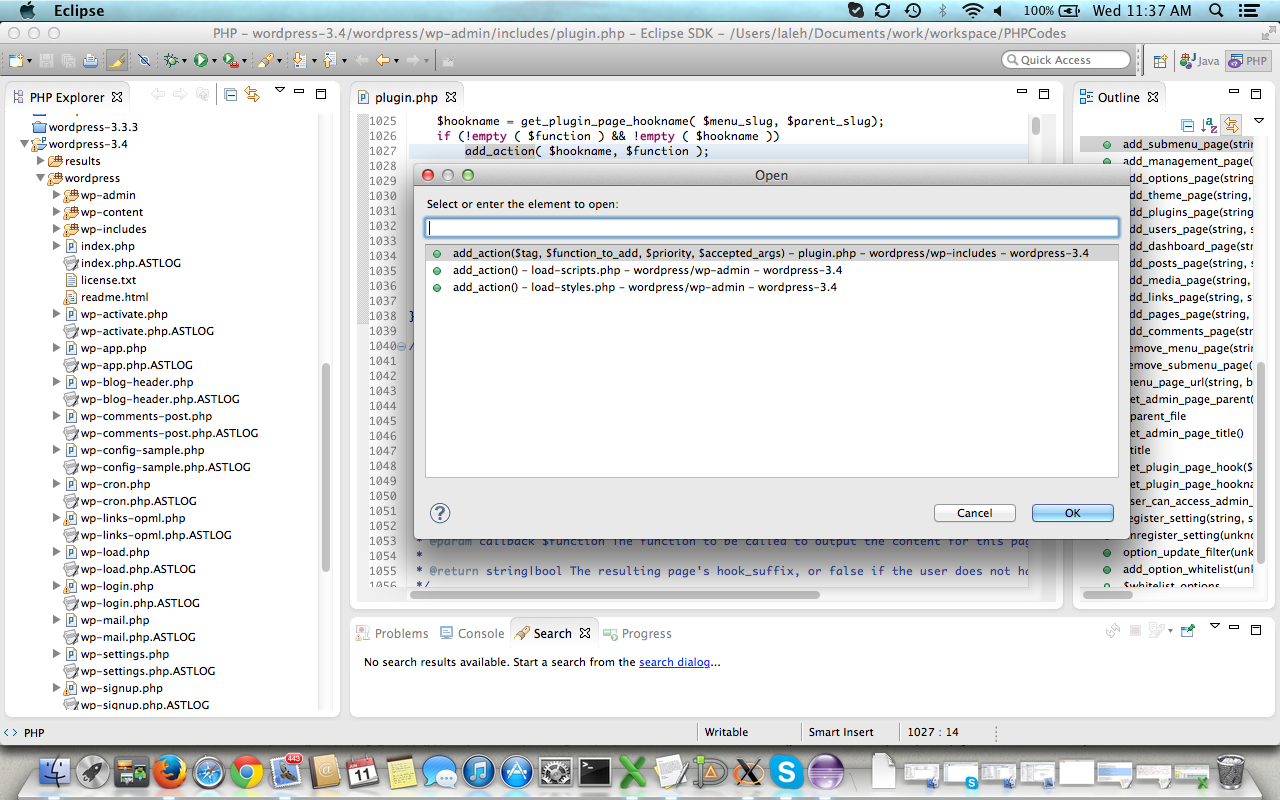

I could not provide example because you need an actual project, but to see what I mean, I attached an image to explain better:
As you see in the image, for the function call "add_action" in file "plugin.php", eclipse proposes three canddiates (one in the same file and two in files script.php and style.php). However when I resolve binding when parsing the same code, I have only one candiate and it is the add_action function in file "plugin.php" (the first one in the list).
So the question is: can I trust the resolve binding in eclipse and be sure that the actual function is indeed in file plugin.php or eclipse simply retured me the first in the list?

PDT is not using include and require while binding. It always looking for all global functions.
So if you have two functions with same name, PDT will collect return types, and next will use to collect fields/methods.
Same for classes. If your project contain two classes with same name (and namespace), PDT will use both of them.
