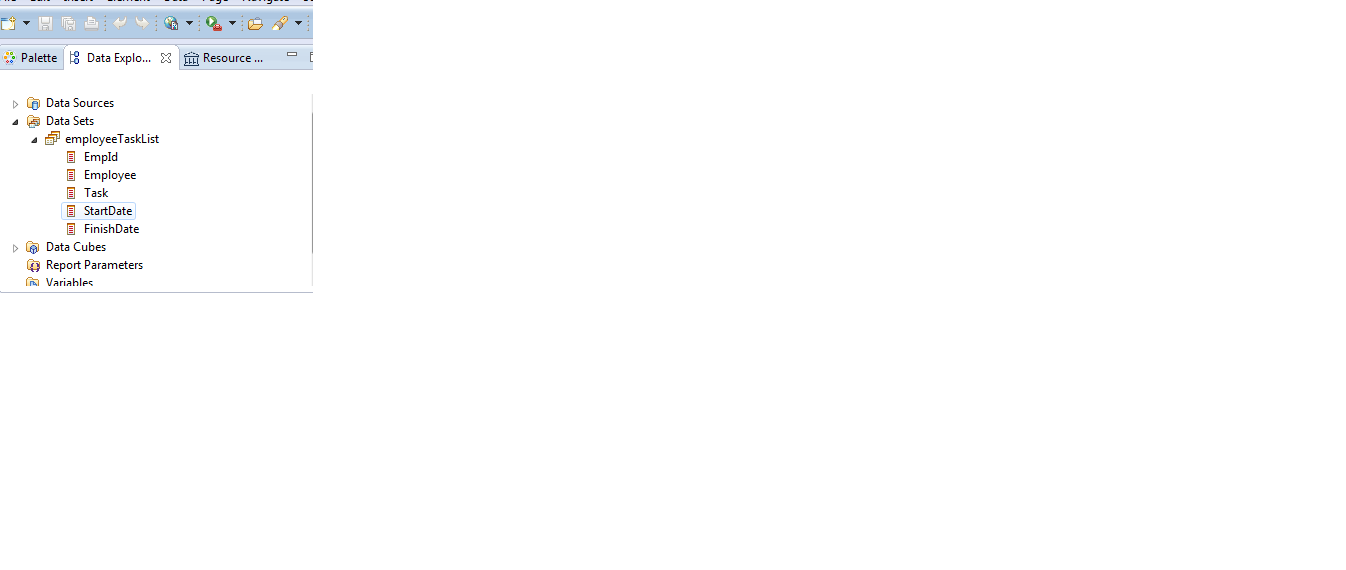

these i have done to have the data .is it enough????.I also have a dataset which i have attached in the picture.I need the dataset to be populated with the data
  • Attachment: Untitled1.png
    (Size: 25.65KB, Downloaded 146 times)
