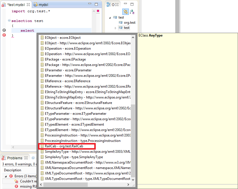

  1. I get a lot of items I can put in there (and my Xcore classes even without an import), but I only want to have those I imported earlier in my import section. How can I do that?
    index.php/fa/18244/0/
  2. When I select my RailCab class like the example above, I get this error: Quote:
    Couldn't resolve reference to EClass 'org.test.RailCab'.
How can I fix these?
@Ed: Thanks to you too, but I don't really know how I can do that... Could you be a bit more specific?

Florian,
Comments below.
On 10/06/2014 5:56 PM, Florian König wrote:
> Hi Christian,
> Thanks for your suggestion! I tried that and changed some things, like this:
> import "http ://www.eclipse.org/emf/2002/Ecore" as ecore
> Import: 'import' importedNamespace=FqnWithWildCard;
> FqnWithWildCard: Fqn('.*')?;
> Fqn:ID('.'ID)*;
> Select: 'select' class=[ecore::EClass | Fqn] name=ID;
> This works, now I can select the classes I created in Xcore :)
> Like this:
> selection test
> select org.test.RailCab
> But I got two new Problems:
I can only suggest you look at the Xcore grammar. I don't really know
your ultimate intent, but something to keep in mind. Xext grammar
language uses Ecore directly and relies on imports that specify the
nsURI of the Ecore model and then further relies on the index to index
all the *.ecore models, including *.xcore representations. But Ecore
models don't know about a fully qualified name just the name of the
package and the name of the classifiers (and structural features/enum
literals). So I'd not expect that approach to let you specify names
like org.test.RailCab. Xcore relies on indexing of all *.genmodel,
including *.xcore representations, and a GenClassifier knows about fully
qualified names in the sense of the generated Java code. So if you rely
on Xcore, you likely want your reference to be to a GenClassifier (or
perhaps more restrictively to be a GenClass). So try that instead of
EClass in your grammar.

Re: ScopeProvider with imported Xcore [message #1385845 is a reply to message #1385761] Wed, 11 June 2014 11:39 Go to previous message
Hi Ed,
Thank you very much! I would have been searching for this forever..
Now I changed some things, like this:
import "http://www.eclipse.org/emf/2002/GenModel" as genmodel
Select: 'select' class=[genmodel::GenClass] name=ID;
This seems to work perfectly fine Smile
@Christian: Unfortunately changing it like xxx=[XXX|ID] did not work.
