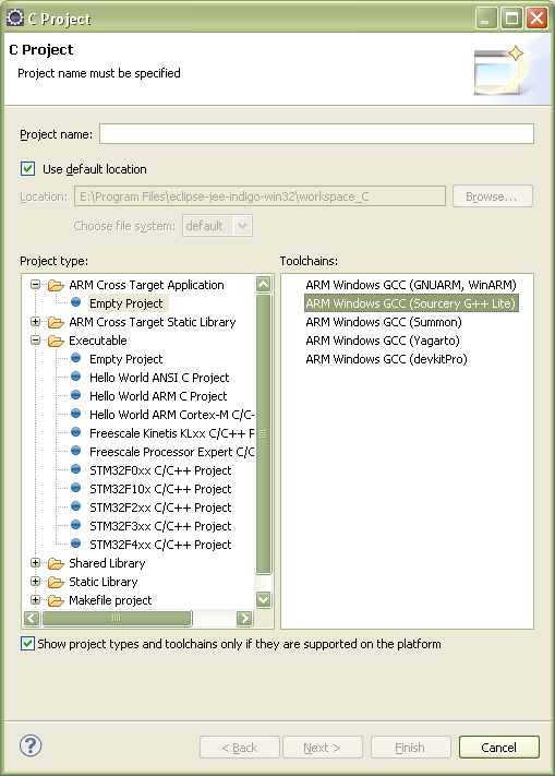

Then I started Eclipse, choose /New/C-Project and expected to see a branch named "ARM Cross Target Application" in the "Project Type" tree with a Sourcery Lite toolchain available for the "Empty Project" under it ... Didn't get that though.
What I have are the "CROSS GCC" and "CROSS ARM GCC" toolchains for the "Empty Project" located under "Executable" ... I simply don't have the "Cross ..." branch for the project type. No idea how to get that.
If I go to the project properties (while setting up a new project) and select the "Toolchains" tab I can select the "Sourcery Lite" toolchain ... but that doesn't change anything in the first tab where the plain GNU tools remain in the tree and no Sourcery tools are mentioned. Yes, I know, Sourcery uses the GNU stuff, but I have screenshots from other people that show "Sourcery" mentioned in that place ... and I only see GNU ...

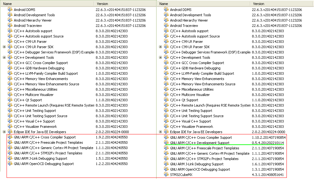

Just made a quick test and it seems that I fixed it ... only stupid thing is - I forgot how Sad ...
index.php/fa/19921/0/
I had a look at the Eclipse Installation History which you can find under Help/About ... I hope my the screenshot image file will be attached to this post ...
index.php/fa/19920/0/
On the left you see the old setup, on the right the current one ... I have marked to locations that might have made the difference ... I know I have also made changes by activating and deactivating stuff because I had to move from Indigo to Kepler ... Please check if you can solve the problem ... if not, I can try to dig deeper and give you more details about my current setup ...
Wish you luck Smile !!

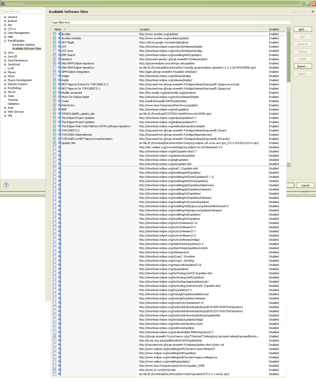

Here's the other half ... where my stuff currently comes from and whats actually activated ...
index.php/fa/19922/0/
Note: I'm not experienced with Eclipse. Actually I'm not very happy with it. So here I do NOT give _recommendations_ ... might all be totally wrong ... I just show what's on my machine right now.
I made separate working sets for the Java and C projects. One particular problem I have with Eclipse is that it hides stuff which one would expect to be visible ... Maybe it makes sense to explore the upper right corner of the Project Explorer window ...

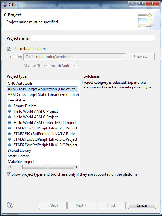

I'm using Luna, and I decided to work my way backwards installing earlier systems until it worked. I didn't suceed. Confused Since I posted my question, I discovered that the ARM Cross Target stuff is now flagged "end of life". (See image)
index.php/fa/19924/0/
I think I'm going to start over from scratch, and try to figure out all the details.
