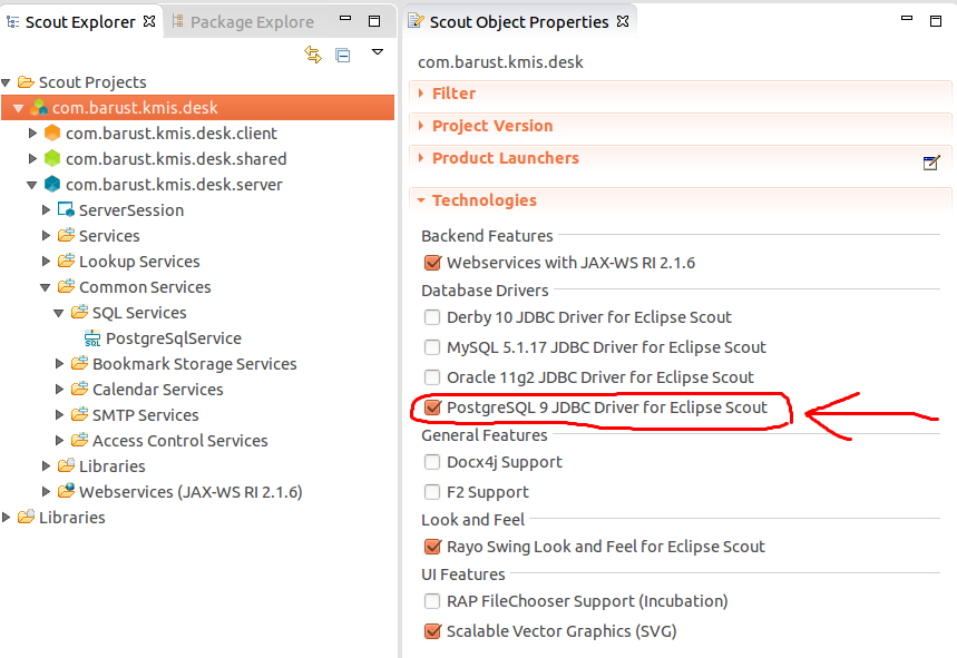

3) Add JDBC Drivers for Eclipse Scout:
-uncheck the box named 'Derby JDBC Driver for Eclipse Scout'.
-check the box named 'PostgreSQL 9 JDBC Driver for Eclipse Scout'.
(for details, see here:http://wiki.eclipse.org/Scout/Tutorial/3.9/Add_JDBC_Drivers_for_Eclipse_Scout)

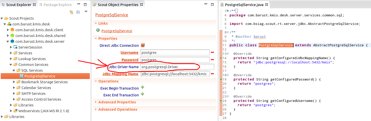

You have described the JDBC mapping name, user name, and password. What is the "JDBC Driver Name" that you use?
Re: How to work with PostgreSQL? [message #1403994 is a reply to message #1403969] Mon, 28 July 2014 23:20 Go to previous message
Hi, G Bits
As you understand, we are talking about PostgreSQL.
To be laconic answer: org.postgresql.Driver
Please, again look at it above :
in addition:
http://i62.tinypic.com/qoyc7l.png
http://i58.tinypic.com/otqcrn.png
