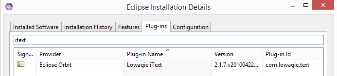

I read here and here that iText needs to be installed manually in addition to BIRT by copying the iText.jar file into some plugin directory in Eclipse. But these installation instructions are all for older versions of BIRT. I'm using BIRT 4.3.2 in Eclipse Kepler, and apparantly iText was already installed (either with Kepler or with BIRT 4.3.2, I can't tell with which).

  • Attachment: itext.jpg
    (Size: 35.86KB, Downloaded 224 times)
