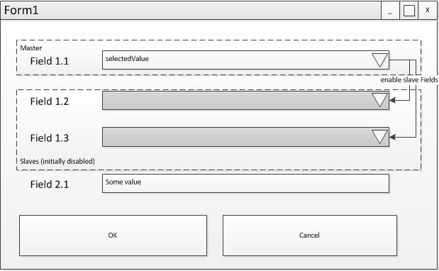

To help you with your problem, can you tell us what UI you are using (Swing, SWT or RAP)? Can you provide a Sktech or a Screenshot of the form explaining the master/slave relations between the fields?

I posted a sketch of our form, which hopefully illustrates the issue.
Once a value in Field 1.1 (master) is selected, Field 1.2 and Field 1.3 become active and in case Tab key is used to jump to the next field, the focus sometimes jumps to Field 2.1 instead of jumping to Field 1.2.
