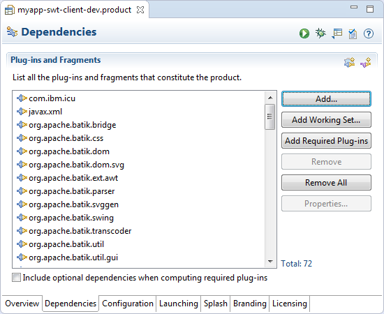

Have xalan in your classpath?
Please check in the client product file (Dependency tab).
index.php/fa/18148/0/
Do you see in the client product file, if you see these bundles:
* org.apache.xalan
* org.apache.xml.serializer
If not you need to add them with the "Add..." button.
When you choose the bundles, if you do not see the two bundles in the list, it means that you do not have them in the target platform.
The bundles are available on the Eclipse Orbit update site.
Do you know how to add them? If not feel free to ask.
If you use a target platform file (for the maven tycho build) the units you are looking for are:
<unit id="org.apache.xalan" version="2.7.1.v201005080400" />
<unit id="org.apache.xml.serializer" version="2.7.1.v201005080400" />
You can add them in the location corresponding to Orbit.
