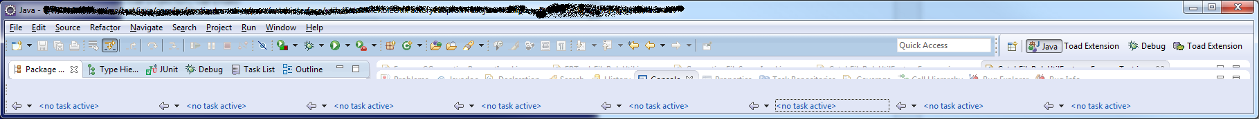

screenshot showing too many task selectors in status bar
when I have to kill my eclipse (via task manager on windows) the mylyn adds a new instance of the "quick task selector" to its status bar. index.php/fa/18132/0/
I raised a bug report on this.
But until this is fixed:
How do I remove the additional instances (avoiding a fresh install of eclipse)?

You can open another workbench window from the Window menu in Eclipse. That should generate a window without the extra trim widgets, then you can close the original window.

Thank you LEO,this did the trick..
