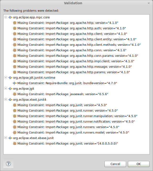

Here's my little problem:
I had been using Eclipse Kepler DSL package, with Xtext and Xtend support, on my Windows laptop. I backed everything (all source anyway) up to "the cloud" using SVN. However I didn't back up any support libraries.
Now my Windows laptop is dying some sort of hard drive death and I'm trying to recreate everything on Mint Linux. I've checked out all my code from SVN and my source explorer window looks the way I expect it to.
Eclipse seems to work OK. I can generate my two language infrastructures that are part of my project, so I know that Xtext and Xtend are working OK. But when I try to launch the new Eclipse application, I am getting the following validation errors.
I don't have the slightest idea what to do about it. Please help if you can. A hint. Anything! Many thanks.

Re: Validation errors when trying to launch Eclipse Application [message #1375671 is a reply to message #1375612] Fri, 23 May 2014 01:00 Go to previous messageGo to next message
Hi the error is that your Plugin respectively its dependencies Miss
some transitive dependencies ( either they are not there or in
different version or - depending on how you start the stuff - product
based or plugin based - you did not select all required plugins

Re: Validation errors when trying to launch Eclipse Application [message #1378087 is a reply to message #1376517] Sat, 24 May 2014 00:37 Go to previous message
The issue is unfolding... slowly... so I had to go into "Run Configurations" and change the setting
index.php/fa/18137/0/
to:
index.php/fa/18138/0/
This at least allowed the 2nd Eclipse instance to launch.
Once there, I found that all of the external Jars I had added to the build path were not found since the project was expecting them to be in their original Windows system path. So I re-added all of them giving the Linux system path and deleted the old ones. Not a huge problem but it would be nice if the path to external JARs could be relative to the source.
