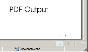

I have a simple report showing several pages.
In the footer of the master page I added a "Pages n of m" autotext.
I choosed the font Arial 11 pt for the whole grid.
In PDF output the vertical alignment of n (PageNumber) and m (Total pages)
are not the same.
The right number (Total pages) is I guess two pixels higher then the left
one (PageNumber).
In HTML output it seems to be ok, see attachment.
I tried everyting to make them appear at same bottom line, but no success.
All settings (font, margin, padding, etc.) in the PageNumber and TotalPages
field are the same and in the related grid cells as well.
What can I to to correct this?
Thanks for any help!

Re: totalpage alignment [message #240593 is a reply to message #240451] Thu, 31 May 2007 05:05 Go to previous messageGo to next message
Hello Jason,
I don't have the sampla database at hand, but I created a report with a grid
with 50 lines, see attachment.
(I use BIRT 2.1.2 under Eclipse 3.2, Windows XP)
If I run this report as PDF one can see the page numbering 1 / 1 and the 2nd
1 is a littlebit higher than the 1st one.
Hope it makes it more clear now,
thanks for further support,
best regards

Re: totalpage alignment [message #240970 is a reply to message #240662] Mon, 04 June 2007 03:25 Go to previous messageGo to next message
Hello Jason,
I downloaded 2.2RC0 and the problem no more exists, so for me its OK now!
