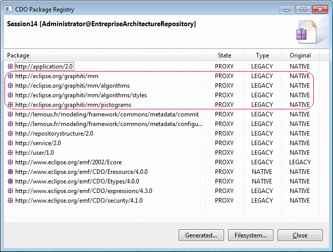

But the server then refuses to start with a 'JdbcSQLException: Unique index or primary key violation' message (see attached log).
Moreover, when I execute my query, the repository is not empty. So I would not get an empty result back.
But, as the server has just been restarted, it seems that the implicit EPackage loading you described does not take place.
So, I had a look to the CDO Explorer package registry and it appears the Graphiti packages are correctly loaded (see attached screenshot):
index.php/fa/18118/0/
Whereas, when I add traces to list the registered packages in my application, only the first Graphiti package is registered !

How is this handled by CDO Explorer ?
And how comes that putEPackage seems to fail without notice until I casually called getType and got a NPE ?
I use CDO 4.3...
Laurent

After some more search, the problem seems not to be whether the inner Graphiti packages are registered or not because, once I opened a diagram, I can successfully run my OCL query and there's still only one package registered in my application CDO session.
But, I just noticed that this single registered Graphiti package is registered with the state LOADED whereas it has the state PROXY in the CDO Explorer.
Could that be the reason ? If yes, how can I change this ?
Laurent
