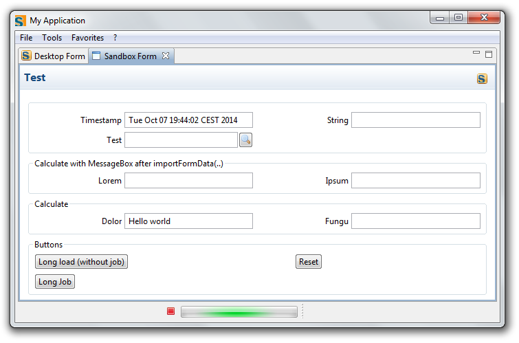

System-Jobs are Jobs that are not visible to the user (They are not displayed in the Job View).
(In our project, we have removed the "Job View" completely).
A typical Client-Sync-Job freezes the user interface, but after a delay.
With the SwtBusyHandler, it is possible to influence this behavior.
For example, it is possible to freeze the whole workbench or just a part of it.
If the whole Workbench is blocked, Eclipse adds a red stop button in the status bar. (See the screenshot below and/or this discussion: Stop Button / "Cancel Current Operation")

One issue still need to be fixed:
When the form is opened (as view in my case), if the load operation (in ModifyHandler.execLoad()) takes a long time, the form do not have the focus when it appears.
This is a problem for our user.
- A form without focus cannot be closed with the "escape" KeyStroke we have in our forms
- Our users want to start working with the form, without having to TAB until the first field is reached.
I hope we will manage to fix this last issue.
  • Attachment: Workbench.png
    (Size: 39.24KB, Downloaded 1191 times)
