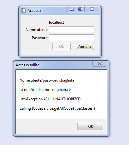

Hi all,
now when I start my application in SWT and press the first character to write the username, return immediately the error message show below:
index.php/fa/18095/0/
And in the console I found the following messages:

  • Attachment: img_Login.PNG
    (Size: 26.87KB, Downloaded 839 times)
