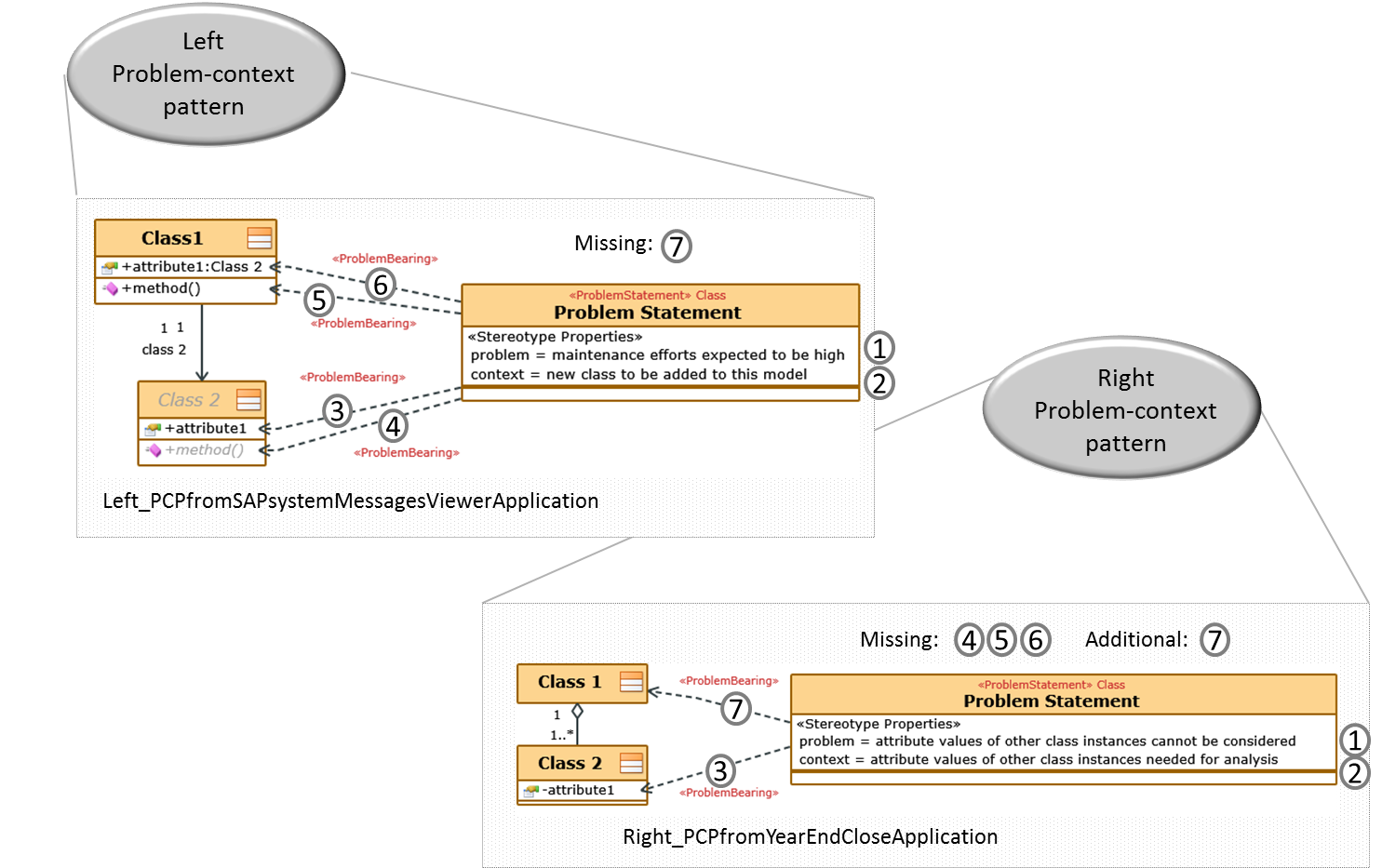

Hi Dimitris,
no problem, of course I can elaborate it a bit more Wink.
Let it bring me to a simple question: How can I count elements of a certain type of the left and the right model? E.g., I tried to do the following: Left!Dependency.count(); => get the number of existing dependencies in the left model. This did not work ;-(.
I attached an illustration of the comparison scenario I have. Note that names of any model elements are not relevant. Only types are evaluated.
Have a look at numbers 3 and 6 in the picture. The ProblemBearing dependency with the supplier type "Property" (called "attribute1") occurs 2 times in the left model and 1 time in the right model. Hence, there is one valid match and one invalid match.
My idea is to find out this difference by counting the elements of a type. That's what I tried to explain in the first submission of my question. Maybe there is more simple way to meet my requirement?
Thanks a lot and kind regards, Alex
Re: [ECL] How to count the number of elements of a model [message #1357004 is a reply to message #1356995] Thu, 15 May 2014 06:11 Go to previous messageGo to next message
Hi Alex,
As discussed in Section 3.9 of the Epsilon book, to retrieve all the instances of a type you can use the .all/allInstances method/property e.g. Left!Dependency.all.size() in your example.
Cheers,
Dimitris
Re: [ECL] How to count the number of elements of a model [message #1372410 is a reply to message #1357004] Wed, 21 May 2014 16:37 Go to previous message
Hi Dimitris,
thanks a lot for the hint. It worked fine. I was able to meet my requirements with these functions.
Cheers, Alex
