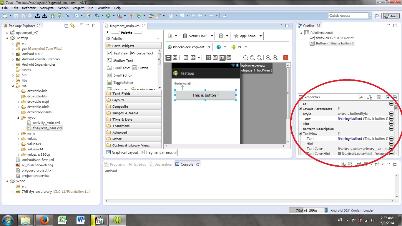

I am having a problem with Eclipse. I am in the process of building an Android app, but every time I work in the "properties window" in "graphical layout", Eclipse closes on its own. This problem doesn't occur if I write code it manually, but I would like to use the properties option as it is faster than writing it.
Below is an image of which properties I am referring, just in case there is any confusion.
Please help!!!!

Two suspects come to mind:
- if Eclipse disappears, this seems to be a crash in native code. Search for a JVM crash log indicating the offending library.
- I assume that this properties view is provided by ADT (it's not from JDT). To be really sure ask the Plugin Spy (Alt-Shift-F1 over the view). Once you know the provider of that view you may want to report a bug against that component.
Stephan
