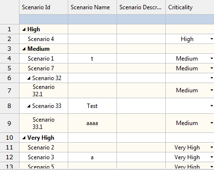

Thanks for the help, I got the solution. I wrote my own customgroupbyLayer which takes custom tree.format and comparator. Great it actually work.
I have attached the screen shot.

I still don't see the need for groupBy as your screenshot does not show the GroupBy area, but if it works for you everything is fine. Smile
Great to see you are using the new modern theme. Smile

Actually Instead of using the composite layer and adding groupbyheardermenuconfiguration to achieve drag and drop columns, I have implemented popup action. In my application the composite area would have look bad in terms of UI because I have some action items also to be provide above. And in my kind of application string column group by doesn't make any sense so only list type, Boolean type and date type columns are allowed to group by through pop up menu check actions which is right now I am developing.
