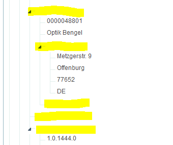

I find a different rappresentation of the same tree in RAP and in SWT. The method to load the information into the tree is the same but the result showed is different (see image below).
I put the exactly xml element into the tree node and I see in RAP that the open/close element isn't showed; is it possible that the problem is the information that I try to reppresent?
RAP Rappresentation
index.php/fa/17996/0/

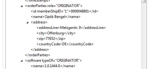

SWT Rappresentation
index.php/fa/17995/0/

I tried to encapsulate the element in CDATA structure (<![CDATA[ ... ]]>) only when the user use RAP interface and now the tree showed ]]> in each elements (see image below).
index.php/fa/17997/0/
Thanks in advance for any help
Re: Tree rappresentation in RAP and in SWT [message #1323339 is a reply to message #1321876] Wed, 30 April 2014 03:50 Go to previous message
Hi all,
problem solved, it isn't necessary use CDATA structure but simply replace < with &lt and > with &gt when working with RAP
