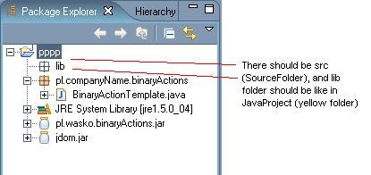

I am trying to prepare JavaProject programatically, i am almost done, but
the problem is with creating specific folders.
First of - source folder - in Java Project labeled by yellow folder and
named "src",
Second - lib folder - in Java Project also labeled by yellow folder and
named "lib",
I attach little picture which shows what is my result,
there is snippet code which shows how i produced it:
Please read also comments - they would explain my "thoughts" :)

the getFile(String fileName) method returns inputstream from which i can
read content of file stored in plugin folder...
What i am doing wrong ?
Maybe there are special methods which creates specific folders ? Or there is
a way to change nature of folder ???
Thank you for any help...
...::WojT::..
P.S. - Sorry for my english....

It look like your project is root source folder.
Have a look here (page 13) for snippet:
http://eclipsecon.org/2005/presentations/EclipseCON2005_Tuto rial29.pdf
Hope it help
Mathias
