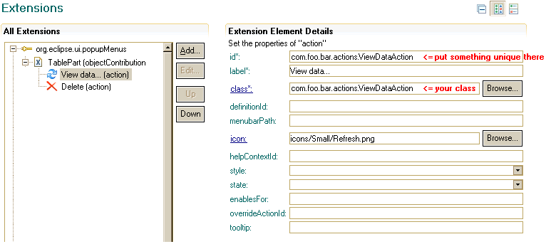

Originally posted by: cricard.businessobjects.com
If like me you plan to rely on object contributions - as opposed to viewer
contributions - all you really need is actions that EXTEND
org.eclipse.jface.action.Action (GEF actions do, have a look at
org.eclipse.gef.ui.actions.WorkbenchPartAction for example), and IMPLEMENT
at least org.eclipse.ui.IObjectActionDelegate (as stated there:
http://help.eclipse.org/help30/index.jsp?topic=/org.eclipse. platform.doc.isv/guide/workbench_basicext_popupMenus.htm,
another interesting interface being org.eclipse.ui.IEditorActionDelegate).
I've included a snapshot of what my plugin.xml would look like if, say, I
wanted to refresh/delete something if one of my TableParts was selected.
Hope it helps,
Christophe.

  • Attachment: Actions.png
    (Size: 7.80KB, Downloaded 152 times)
