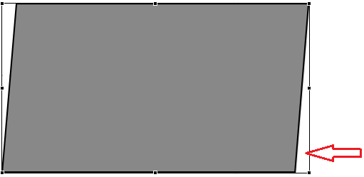

Hi there,
I've taken a closer look at the shapes of containers and came across a little annoyance. As you can see in the picutre below the bounds of the parallelogram are always rectangular. Those bounds aren't visible till you click on the shape. If there's now a shape right behind this "invisible" boundary I'm not able to click on it.
Is there a way to change the rectanglar boundary to actually fit the parallelogram without any spaces?

Le 14/04/2014 16:33, Florian Dunz a écrit :
> Hi there,
Hi Florian,
Non rectangular shapes are currently considered rectangular for edges
connections, selection, ... Unfortunately there is no way to simply
change this.
If you provide your own figure to Sirius, you might try the following
tips, but this could have side effects and it could not be sufficient to
get other features work in a non rectangular way (resize, feedback,
handles, ...):
. It is possible to define a polygon on which the edges have to
be connected, see
org.eclipse.gmf.runtime.draw2d.ui.figures.IPolygonAnchorableFigure.getPolygonPoints()
and a tutorial [1]
. For the selection issue, an entry point is
org.eclipse.draw2d.IFigure.containsPoint().
Its base implementation (org.eclipse.draw2d.Figure) simply returns
getBounds.contains(x,y).

Thanks for the quick reply!
Both tips were really helpful. I've achieved being able to click through the "invisible" areas to select an element behind it.
org.eclipse.draw2d.IFigure.containsPoint() was the right method to look at.
