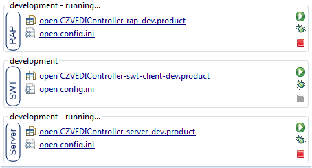

Hi all,
I have the following problem: my scout applycation doesn't start in RAP mode.
When I start the server-side, the console show me the following messages:
!SESSION 2014-04-07 17:07:36.565 -----------------------------------------------
eclipse.buildId=unknown
java.version=1.6.0_24
java.vendor=Sun Microsystems Inc.
BootLoader constants: OS=win32, ARCH=x86_64, WS=win32, NL=it_IT
Framework arguments:  -product org.zeiss.mo.scout.CZVEDIController.server.product
Command-line arguments:  -product org.zeiss.mo.scout.CZVEDIController.server.product -data C:\Projects\scout/../runtime-CZVEDIController-server-dev.product -dev file:C:/Projects/scout/.metadata/.plugins/org.eclipse.pde.core/CZVEDIController-server-dev.product/dev.properties -os win32 -ws win32 -arch x86_64 -consoleLog
!ENTRY org.zeiss.mo.scout.CZVEDIController.server 1 0 2014-04-07 17:07:38.708
!MESSAGE org.zeiss.mo.scout.CZVEDIController.server.ServerApplication.start(ServerApplication.java:44) CZVEDIController server initialized
When I start the RAP-side, the console show me the following messages:
2014-04-07 17:07:56.880:INFO:oejs.Server:jetty-8.1.3.v20120522
2014-04-07 17:07:56.961:INFO:oejs.AbstractConnector:Started SelectChannelConnector@0.0.0.0:8082
index.php/fa/17893/0/
But after that nothing happens.
I try to launch my application directly from IE, but IE return to me the message "Impossible show the web page".
I think that the problem is located on the config.ini of RAP or/and Server side, but this error escapes me.
I use "Eclipse Scout Juno 3.8"
Any suggestions or advices are appreciated. If you need other information not reported here, free to ask.
Thanks in advance
