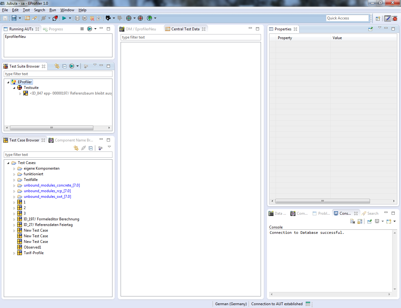

Re: Cann´t test after a Software update(my AUT) [message #1386116 is a reply to message #1282365] Fri, 13 June 2014 09:03 Go to previous messageGo to next message
Hy Alex, sorry for the late reply, but because of some exams and other tasks at work, I haven´t time for my jubula project.
- the logs are empty
- it is not possible to start the execution. How you could see into the picture, the Button is chose able, but nothing happens.
If you press to the OM, Observing it worked a moment, the button become gray and after 0,5-2 Minutes it´s the same like the beginning.(Without doing what should)
- I´m not using a remote desktop
- My oldest program version works without any problems. If I´m updating this version, there is no problem, but if I want to install one of the newer one, there are the problems. After a update from eclipse Juno to Kepler it´s not possible to update my ATU, so I must install it new.

Re: Cann´t test after a Software update(my AUT) [message #1386117 is a reply to message #1386116] Fri, 13 June 2014 09:04 Go to previous messageGo to next message
No Message Body
  • Attachment: d.png
    (Size: 126.15KB, Downloaded 164 times)
