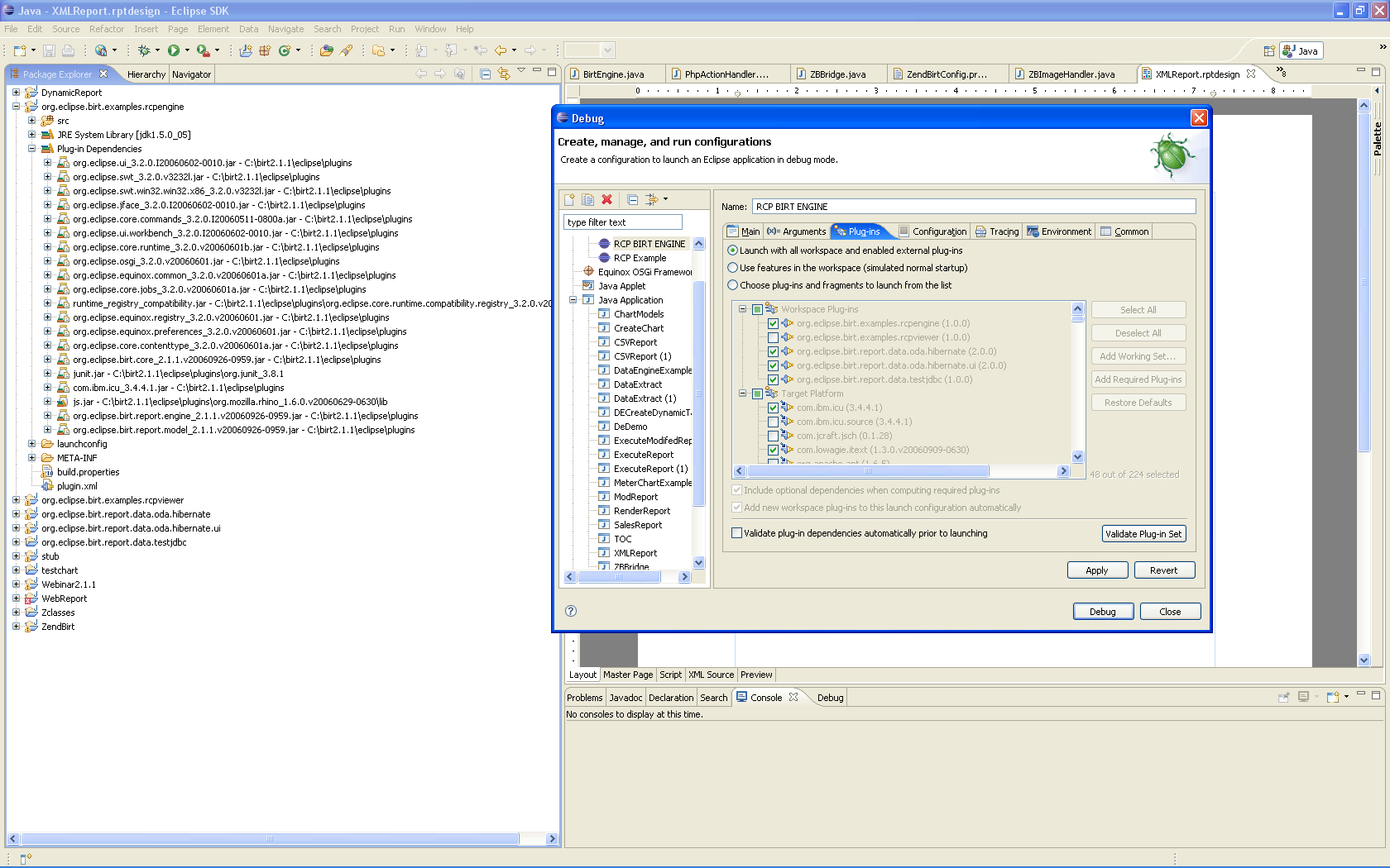

Can you try the sampledb?
Also I noticed 2_1_0 in the runtime folder referencing a 2.1.1 plugin. Was
this just a typo?
If you are running this through a debugger, make sure you have the jdbc
plugin selected in
your launch configuration.
Jason

Here is a screenshot of my workspace.
Can you launch the debugger with all workspace and external plugins enabled?
Make sure you have copied all the BIRT plugins to your plugins folder.
Jason
